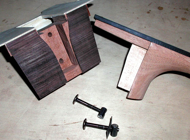

I PM'd Grant and asked if he was game for some discussion of his adjustable neck joint, and he said sure. Here's a photo of it. It's wonderfully simple - basically just an ordinary bolt-on mortise and tenon joint with a shop-made spring at the lower bolt. The upper bolt is tightened up first, then the lower bolt is tightened until the neck angle is right.
The sides are cut out to let the neck heel in, just the thickness of the sides (if you want to see a pic of that, I, or Grant, could post one). That's enough to allow all the necessary movement of the neck without showing a gap. That's a feature I like as well; much as I respect and admire the work of builders whose adjustable neck designs feature the hardware exposed, rather than hide it, that's an aesthetic choice that would not be my own.
Obviously, the fretboard extension support just floats in a cut out area of the top - with the fretboard tongue itself just barely off the top.
Grant, please correct me if anything in my description of your joint is incorrect, or elaborate on it if you'd like.
Now, here's my question for you, Grant. It would seem that this design would allow some movement of the joint as the spring compresses and rebounds (however slightly) with the oscillation of the neck and body as the guitar is played. It would seem that this would have a negative effect on the sound. Can you enlighten me on this? Have you observed anything in the sound of your guitars made with this joint that would even hint at a loss of power or tonal quality as a result of this "springy" joint?

I wonder if that joint has a solid contact point near the top of the heel, close to the fretboard where it may act as a hinge. Then the only flexable point would be the heel and that, it seems to me, would be a non-issue concerning the absorption of energy from the strings. As long as that high contact point, which is pretty much in line with the pull of the strings, is rigidly supported the neck seems well designed.

In this joint, the spring is just providing preload for the bolt. The stiffness of the joint (if you're trying to open or close the gap) is the same as the stiffness of the bolt in parallel with the spring. And, the bolt is very stiff in tension and compression (maybe a hundred or a thousand times stiffer than the spring).
The bolt provides high stiffness to the joint even if you're pushing down on the neck (trying to close the gap) until you completely overcome the spring preload and unseat the bolt. Until that point, the joint will be quite stiff.
And, you would have to overcome not only the spring preload, but the additional preload of the strings, that are also adding to the tension in the bolt.
You might even be able to leave out the spring entirely, and rely on the string tension, but the neck would be really floppy until you strung it up.

I follow you, Phil, and that makes sense to me... sort of. Thinking of the structure as a static thing, it makes sense. The string tension pulls the neck upward with a great deal of force and so the bolt stays seated and everything is solid. EXCEPT that when the guitar is played, now everything is moving. Among the many modes of vibration in the instrument, one is that entire guitar is oscillating lengthwise, like a long bar from headstock to tailblock. In the middle of this "bar", you've got a joint that can pivot (at the upper bolt area of the neck joint). The question, as I see it, is whether the energy of that oscillation is strong enough to slightly compress that spring in there, slightly unseat the bolt, and thereby diminish the solidity of the joint as things are in motion.
I understand you've got string tension always pulling the neck up, even while things are oscillating... I'm just not sure how it all actually plays out. Maybe the string tension is always strong enough, in combination with the spring's force, to keep the bolt firmly seated even when everything is oscillating... but I wonder. After all, it is the rapidly _changing_ tension of the strings in vibration that is (at least in part) setting the "bar" into oscillation... maybe the energy of that changing tension and resulting oscillation could wobble that joint at the pivot point in spite of the presence of the spring.

First of all, Thanks Todd, for starting this. I have been meaning to show this, but have been running too much to find the time.
OK, I can see your concern. However, this joint is way more solid than you might think. The top bolt is torqued down very tight. You could probably leave everything else out and be fine to play. I should note that the bevel on the end of the neck tenon which allows for the adjustment starts at the lower edge of the top bolt hole, so above that there is a square fit for tightening the top bolt. The total amount of adjustment that I build in for the bottom bolt is one complete turn after it is snugged up. With the 1/4 x 20 threads on the bolt, that is 1/20". This will drop the nut almost 3/8". But to do this, you really have to crank on the allen wrench, and you hear creaking and groaning while doing it
The key to this joint is to make sure that the neck angle and alignment is dead on from the get-go. Don't rely on the adjustment feature to compensate for sloppy fitting. Inletting the neck heel through the sides is exacting work, but actually quick and simple. Since there is no glue in any part of this joint (the fingerboard extension floats), removing the neck to make fine tunings to the fit is simple. Or a take-down guitar for travel
As for the sound, there is NO detrimental effect from this joint. These guitars are extremely loud and uniform regardless of the vigor of playing. Though I am not sure how much of a contribution is due to using white spruce tops or my "strange" bracing system.

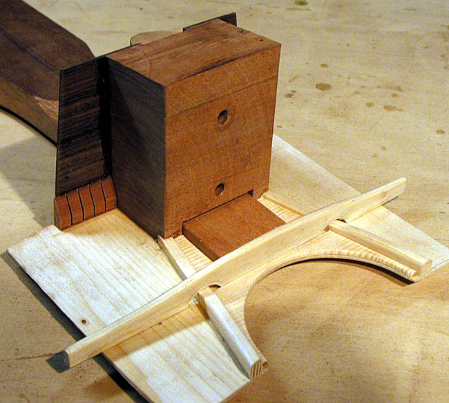

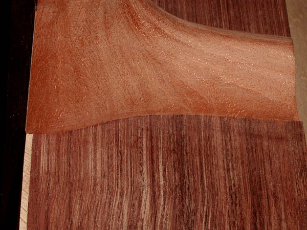

Just a few more photos. Also, somewhere I have a sketch drawing of this thing, but have not been able to locate.
These photos are from a full scale mock-up that I did before trying this on a real guitar.
Here is the whole thing ready to assemble. At the top edge, the shoulders of the neck seat firmly on the face of the neck block and the end of the tenon from the top bolt hole up seats firmly on the end of the mortise. Starting about 1/2" from the top, the face of the neck block along side of the mortise bevels in to allow the neck heel to pivot inward.
Here is a view of the inside after assembly showing the modifications of the upper end bracing. Since there is no downward pressure on the top from the neck extension, the upper transverse brace can be scaled down. This one is only 3/16" thick by fairly tall. The two "A" braces along the soundhole seat in notches under the corners of the neck block. They pass through cutouts in the upper transverse brace.
Here is a view of the outside of the joint showing the fit of the neck heel into the sides. I just fit things together with a completely sanded neck heel and scribe along the edges with a utility knife. I deepen the cut and remove the side pieces with a small chisel. Then do any cleanup with a small file. The whole thing takes about 15 minutes. One important thing, the sides of the neck heel need to be straight for the thickness of the sides plus a bit more so the joint does not open up if the neck heel is adjusted inward. Do leave a uniform gap the expected thickness of the finish on the neck heel.
